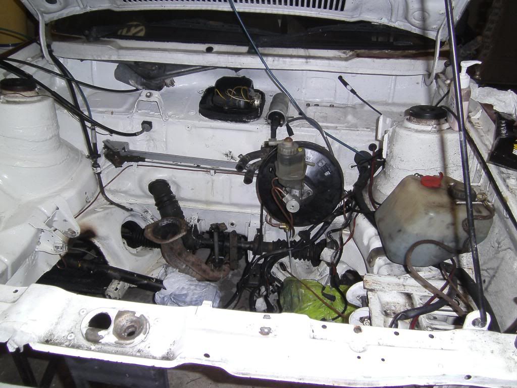

Update: Still haven't found a local engine yet but started work collecting parts needed. - mk3 golf servo and master cylinder, - mk2 coil - Electric fuel pump. Also dropped my engine down and out from its hole its been sitting in for about 27 years.    Now to clean up all the oil from the bay and loose the servo and master cylinder.

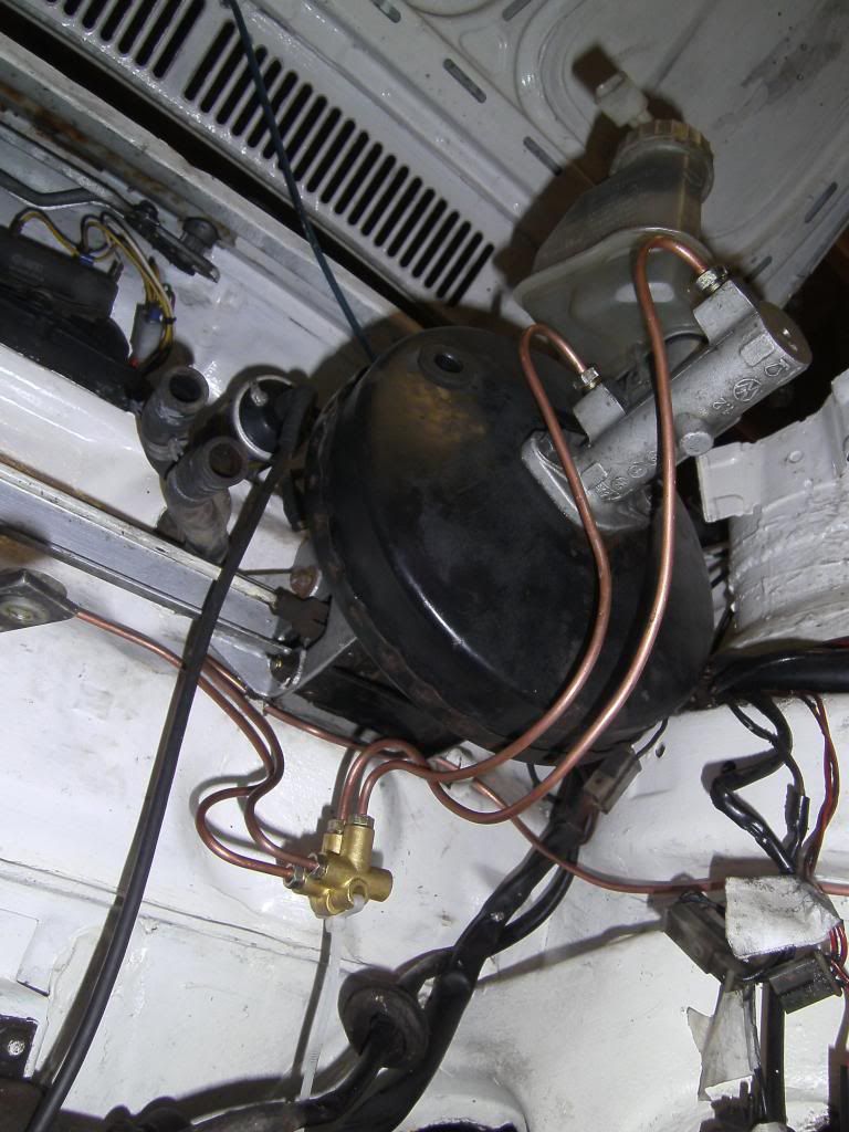

long time no update. Cleaned 95% of the engine bay with oven cleaner and a cloth.  Modified the bigger mk3 golf 16v servo and master cylinder to fit the mk1 brake arm and fitted. Almost completed the new copper brake lines front and back so now use 2 master cylinder inlets instead of 4 plus the brake switch (which will be moved to the brake pedal using a mk3 switch and a DIY bracket.  Also got delivered some clear lacquer so once the brakes are done I can roll it out, give it a clean and then treat and re-lacquer the parts of surface rust that have gone too far. That is all.

the hardest part is removing the old brake lines without rounding the nuts as theyve been on our vws 25+ years. Copper line is easy to bend just hard to make two lines look the same as you cant do it out of the bay as it has to go through and around bits. And you need a flaring tool. Im borrowing mine. Took me about 10 hours including removing old lines and rounding 3 of the 8 nuts I removed. I used 10 metres of line. Ebay Linky

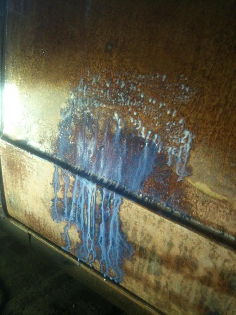

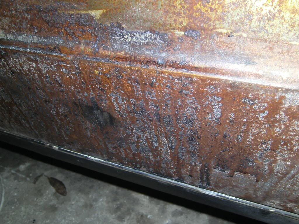

Im still waiting for more funds to buy a donor car however decided to experiment whilst sanding down some of the deeper rust. I did some spots of Kurust on the raw rust before lacquering to see how it would look.  Turns out quite well adding some darker patches into the rust.

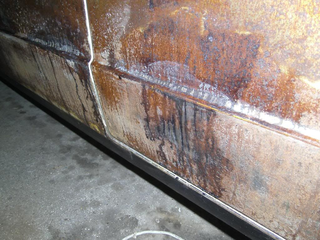

My daily car is still giving me grief and needs ANOTHER rebuilt engine so funds cant stretch to my caddy engine yet and unlike to now until the summer. Very disappointed as I was hoping to do a few more VW shows with Berkshire Mk1 Golfs this summer. ANYWAY my experiments with paint and kurust are continuing, yet my explanations probably wont make sense and will hardly by noticeable to others. I should of taken off the excess liquid whilst it was still wet. I just spend some time with T-cut taking it off now its hardened, this is to merge in the patches but I'm pretty pleased with some of the results. The Kurust has turned some of the deeper patches black yet leaving the flatter rust and none kurust parts "clean".   The painting parts are still in progress but will layer similar to the bonnet. Im going to try a door embalm yet with a difference.

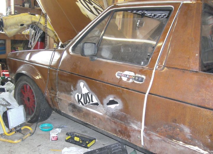

so update of paint being added (then taken away) This is one of the front fenders, I'm pretty pleased with it now as it merges in nicely with the lower paint work. What do you lot think?  And this is the fake original door embalm in progress:  Ive decided this is going to have to be sanded in by hand so not to loose too much of the lettering. This will be done next saturday.
