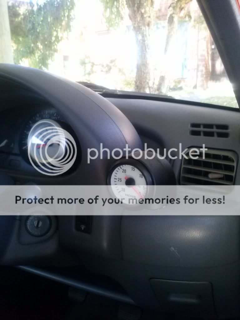

also brought a vaccume gauge ( $16 posted ) and volt meter ( $2.50ish posted )
just so i know what the cars doing and a bit of bordem haha might add a cabin temp gauge ( and/or water temp gauge ) next to the volt meter..
out of the way hidden, but still easy to see if needed :)
Volt meter - just used a stanley knife to cut away the foam on the inside, fed a wire through, drilled hole though the mounting bracket and ran the wire thru the pillar
vacuum gauge - used a bit of 2" right angle pipe, cut the hole in the dash and painted black pretty simple not bad for $3

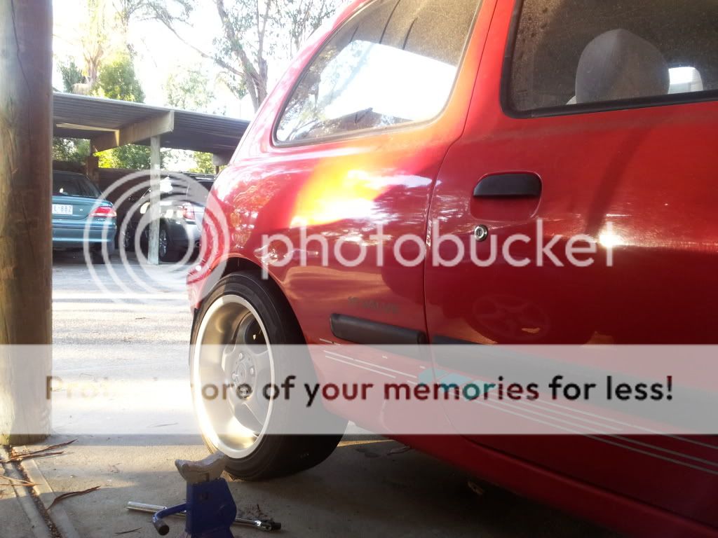

:fawkyeah dat poke ;)

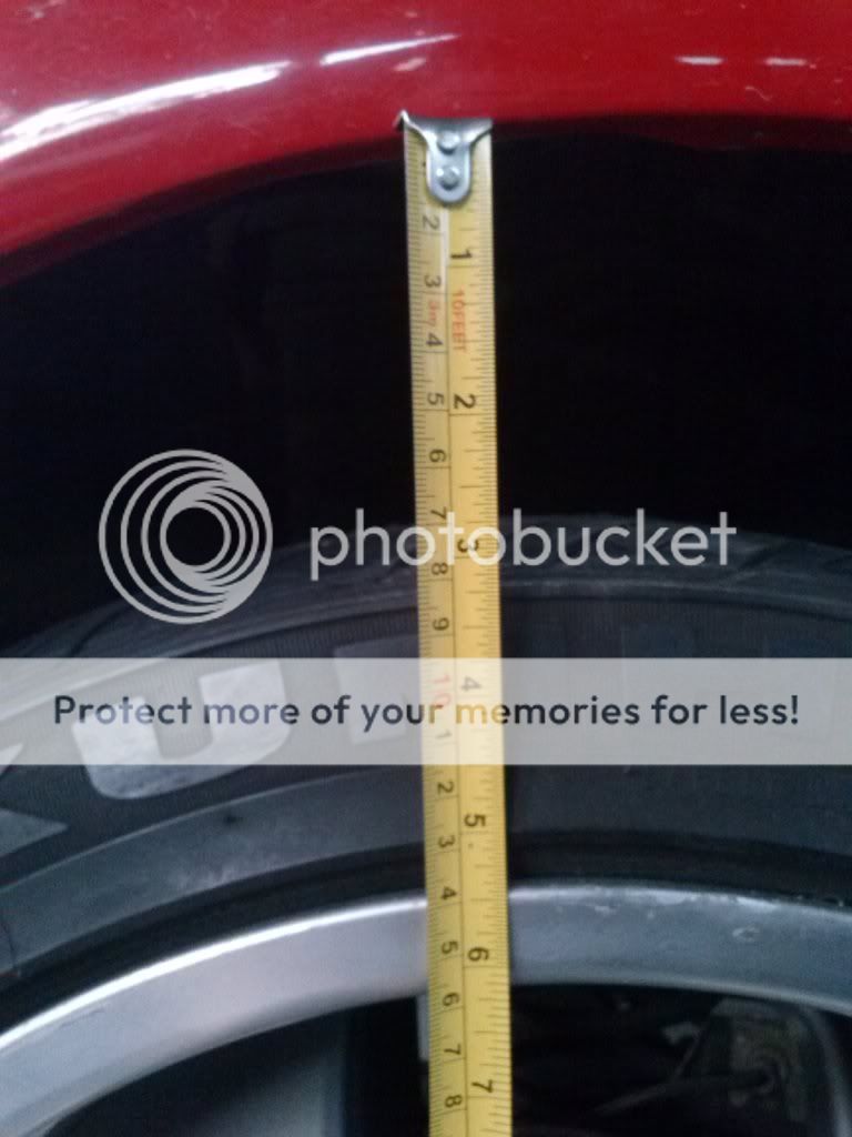

front is about 15mm from guard to rim
rear is about 5mm

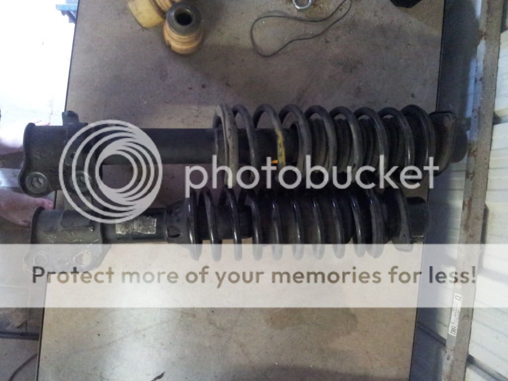

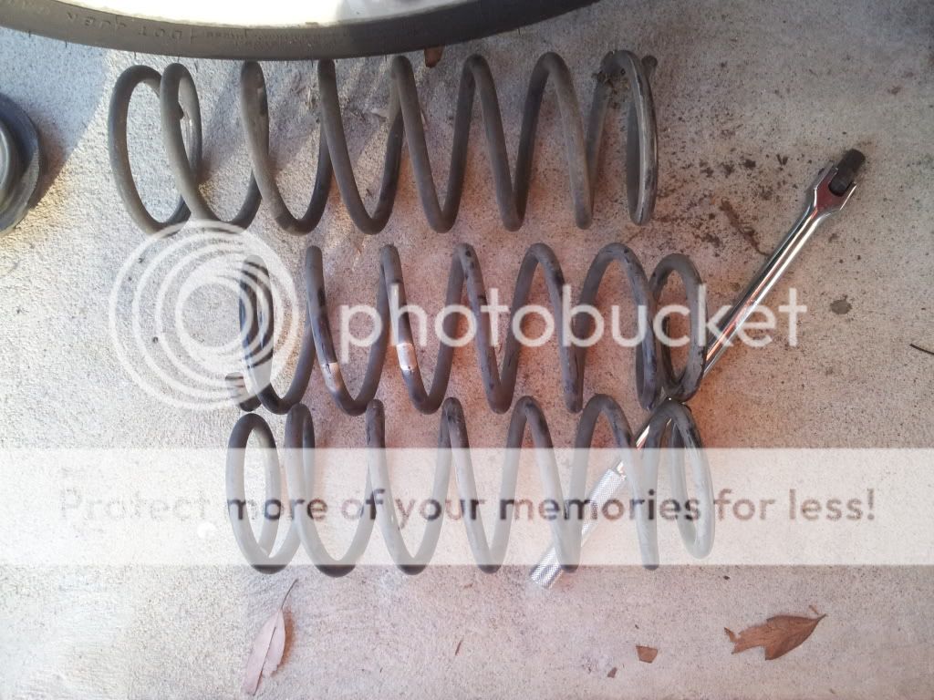

going to use martiz front struts / springs with suzuki alto rear springs and barina rear shocks ( Corsa rear shocks for most people on here :P )
top micra stock strut... bottom martiz shock/spring waiting to go on
top is micra stock rear spring bottom 2 are alto springs test fitted the rear's today ;)

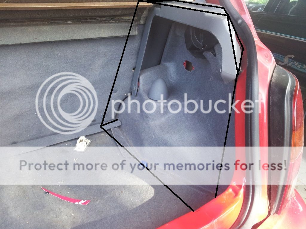

and might move the 2 x 12's into the boot, but still a bit undecided on that was thinking on either side of the boot
but the left box would be slightly smaller then the right? not sure if itll have much effect on the sound ect
would fiberglass the back half and plastic part that holds the rear shelf on would be apart of the box removeable of course just hold the front in the a couple of brackets so can get to the lights when they go pop.. would be a bit bigger box then in the other place but looose 1/4 the boot space lol
thoughts on all of the above and more welcome haha

already scrubs a bit with the 15's pretty sure its the rear mudflaps on the rear, front has been pretty good for now haha
going to lower it either way :crazi

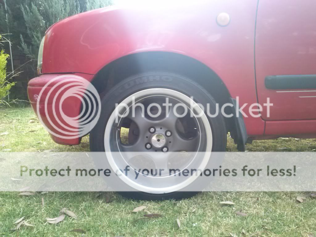

put stock alloys back on for now, save getting defected untill lowered and get some flares :smash
front was about 30mm sticking out from the guard ( 20mm if camber was straight dam stock struts had a few degrees ) and rear was 10 - 15 ( more room in the rear but still pokie )
rather runs stock alloys then $300+ fine pretty sure it is :(

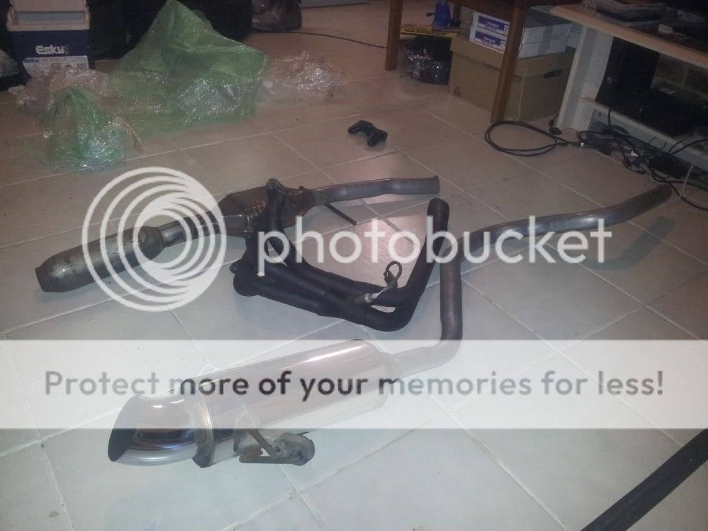

trying to work out how to fit the exhaust haha, looks like half the front of the car has to come off
and need to modifiy one of the header pipes so it fits in with the aircon ect ... warm up the welder again i guess
then when i get it all in weld some flanges onto it.. when i can get the time to pull it apart :(

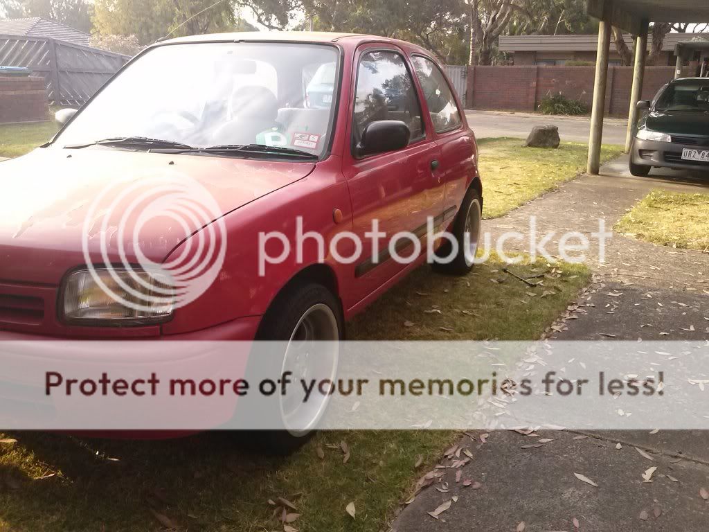

micra sitting 50mm lower! :D handles a heap better no more granny rock crawling spec
running stock 13's still.. need to roll the guards and panhard rod on order :)
then can keep the meshies on their :D
