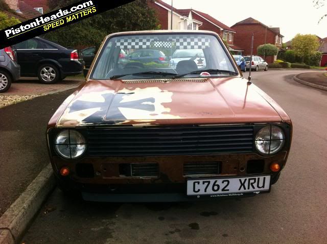

So I got it like this:
After my past cars and knowing Im not into the "clean" look I decided I like the rat look.
Came with:
-12 months MOT and 1 months tax,
-Front adjustable coilovers and flipped rear axle,
-BMW E30 wheels powder coated red,
-Custom wide arches,
-Bully tailgate netting,
-MkII seats,
-MkII grill,
-Custom aerial and gearsticks,
-Original Tailgate (matching ratlook)
-Roof rack
-Chrome bumper
-flag mirrors
-Flat rear window
etc....

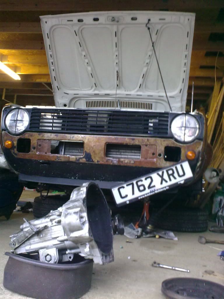

was replacing my speedo cable tonight but I managed to drop the plastic green speedo cog thingy (with some of the old speedo cable still attached) down into the gearbox! :bh
As its out of reach now the gearbox has got to come out with some help from a VW camper friend.
no I tried with a friends magnetic stick monday night. Think I pushed it past the large gear cog to the left (looking from the front) so cant see or catch it. :(
Depending on whether I go climbing tomorrow night, the box might be out by bed time tomorrow. Whilst its out Im going to do the clutch.
Manged to unsieze the OS adjustable coilovers and raise it an inch as it rubs when going into the drive way. I'll give it a finer adjustemnt once running nice.
Right with alot of help from a friend the gearbox was out in just over an hour.
Poured out the oil and only about half a pint came out and it was like melted chocolate!! :0 So now it looks like the gearbox is going to need a refurb/bearings. 3D transmissions wanted stupid money for doing the work so my friends going to do it for me.
Also the clutch is well worn so thats on order too. Hopefully that'll be the grinding gear changes sorted and not the DIY clutch arm repair.

Update:
Gearbox is in, got to find two bolts to finish the box back mount, speedo cable, fit the alternator and air filter. Will do this tonight.
Then run it up to a mates to tune the carb, fit a new cam belt and get the timing spot on.
